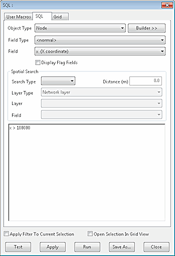

x > 100000
Selects all objects of the chosen object type (selected in the Object type field of the SQL Dialog) where the x coordinate > 100000.
This basic selection example selects all Node objects with x coordinate greater than 100000.

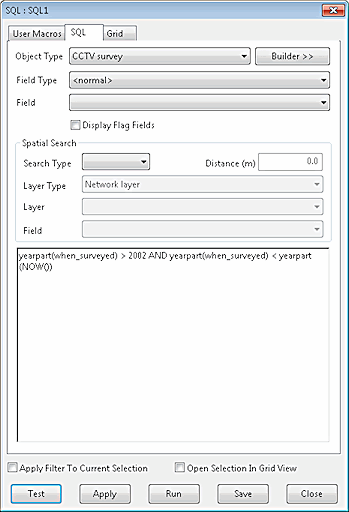

Example 1 Example
yearpart(when_surveyed) > 2002 AND yearpart(when_surveyed) < yearpart(NOW())
Finds all the CCTV surveys undertaken after the year 2002 and before the current year.
Object type: CCTV survey
Field: When_surveyed

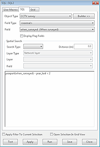

Example 2 Example
yearpart(when_surveyed) - year_laid < 2
Finds all the CCTV surveys that have been surveyed within 2 years of the pipes being laid.
