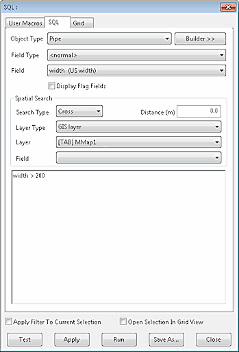

It is possible to carry out spatial searches using the SPATIAL keyword, or between any two network layers or between a network layer and a background network layer or GIS layer as outlined below:
- Choose the Search Type. (These are described in the table below.)
Select Layer Type:
- Network layer: object layer in the current network
- Background layer: network layer of network opened as a background network in the GeoPlan
- GIS layer: GIS background layer displayed behind the network in the GeoPlan
- Spatial rain layer: the rainfall radar cells used in the simulation, the results of which are displayed in the GeoPlan
- Select the layer in the Layer box.
When searching using a background network layer or GIS layer, the layer must be loaded in the GeoPlan View.
When searching using a spatial rain layer, the results of the simulation must be loaded in the the GeoPlan View.
The layer is then referred to in the query as spatial.

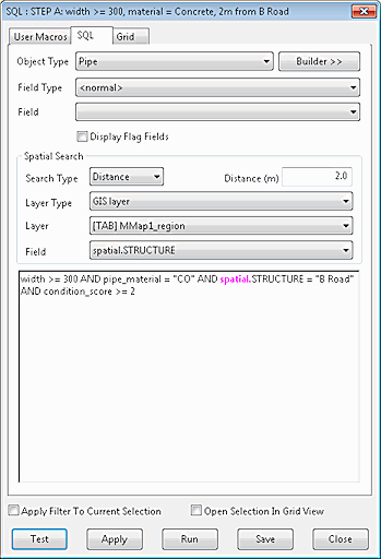

- To include a field in the spatial layer search, select the field in the Field box, or enter directly into the edit box using the syntax shown in Figure 1 where the field name is included in the query - spatial.STRUCTURE
- Use the spatial fields in the query in exactly the same way as network object fields
Click on the image below to show an example which uses GIS data to find damaged concrete pipes at least 300 mm in diameter that lie within 2 metres of a minor road.
Example
GIS Search Example
