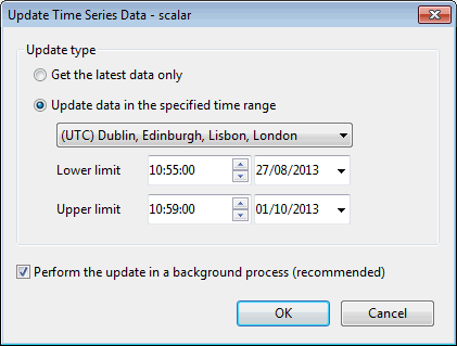

Update type
This section allows users to specify the type of update.
Get the latest data only- Select this option to perform a latest update ( optimistic update). When this option is selected the time zone, lower limit and upper limit controls are disabled (see below).
Update data in the specified time range - Enable this option to perform a ranged update ( pessimistic update ) based on the dates specified in the Lower limit and Upper limit fields. Selecting this option enables the following controls:
  • Time zone – Time zone to use for the time range specified in Lower limit and Upper limit. The default time zone is the machine time zone.
  • Lower limit – Defaulted to the current date and time.
  • Upper limit – Defaults to the current date and time.
See Updating Time Series Data for more information.
Perform the update in a background process (recommended)
Checked by default.
When this option is checked, the time series data update will be executed in the background, as a server job. The Schedule Job(s) dialog, where schedule configuration takes place, will be displayed when the OK button is clicked on the Update Time Series Data dialog.
Tip: It is recommended that this option is checked as updates can be time-consuming and implementing them in the foreground may prevent users from carrying out other tasks on the computer.
Note: If Perform the update in a background process option is checked, then updating from an "access" external data source can only be done by selecting an agent that has a 32-bit version of InfoWorks ICM installed. If Perform the update in a background process is unchecked, updating from an "access" external data source can only be done in a 32-bit version of InfoWorks ICM. This is due to incompatibility of JET databases with x64 applications.
