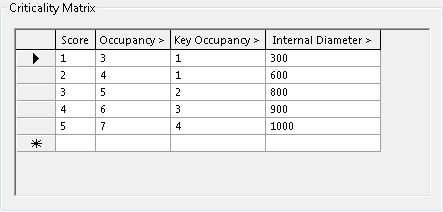

Ratings based on occupancy and pipe diameter
Ratings are calculated based on the number of customers supplied by the pipe and the internal diameter of the pipe.
The criteria to be used to determine a consequence rating are defined in the Criticality matrix in the Consequence Calculator. The criteria in the calculator can be edited, rows may be deleted from the grid or further values added to the bottom of the grid.
The Criticality score field of the pipe is updated with the consequence score calculated from the Criticality matrix. If the Criticality score is greater than the consequence ratings determined from the Critical factors, the Criticality score will be the value with which the pipe Consequence score field will be updated.
| Criticality matrix column | Description |
| Score |
Consequence rating. |
| Occupancy |
Number of customers supplied by the pipe. Calculated as the sum of the Occupancy values of Property objects associated with the pipe. If a property does not have an Occupancy specified, the Default occupancy value specified in the Consequence Calculator is used for that property. |
| Key Occupancy |
Number of key customers supplied by the pipe. Calculated as the sum of the Occupancy (Key) values of Property objects associated with the pipe. If a property does not have an Occupancy (Key) specified, the Default key occupancy value specified in the Consequence Calculator is used for that property. |
| Internal Diameter | Diameter of the pipe taken from value specified in Internal diameter field of pipe. |
