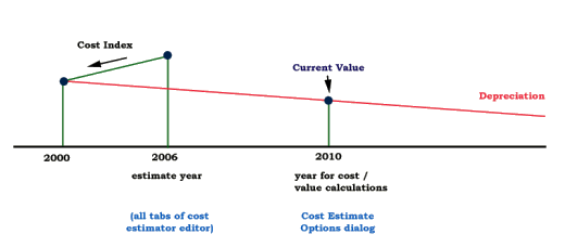

Depreciation costs
Depreciation costs as such are not calculated by the cost estimator. However, it is possible to estimate the depreciation cost of an asset as the cost estimator calculates the asset current value (depreciation cost = installation cost - current value). Depreciation rule is considered as linear in InfoAsset Manager.
Show me
Example of diagram showing how the cost estimator calculates depreciation costs (asset current value)
