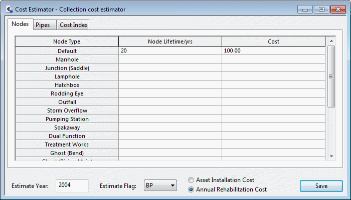

Nodes Page - collection networks only
The Nodes page contains a grid that specifies the lifetime and installation/rehabilitation cost for each type of node in the database. It is not required to specify information for all node types. Any fields left empty will take the value specified in the Default row of the grid.

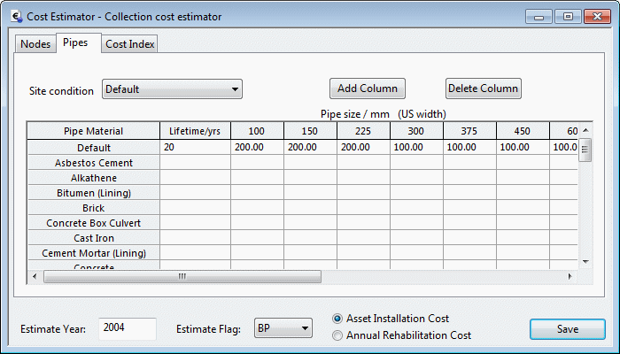

Pipes Page
The Pipes page contains a grid of costs varying according to pipe material and pipe width. The pipe installation/rehabilitation costs in the grid are specified per unit length of pipe. Adjusting the Site Condition setting shows a new grid of values that may be specified (for example costs of pipes laid under a road will be different for those in unpaved areas). Any fields left empty will take the value specified in the Default row of the grid.
Show me
When the cost estimator is created a default set of standard pipe sizes is created.
  • Click on the Add Column button to specify an additional pipe width. The Add Pipe Width to Estimator Dialog will be displayed. Enter the new pipe width to be added to the cost grid and click OK.
  • To delete a column, select the column by clicking on the column header in the grid and press the Delete Column button.

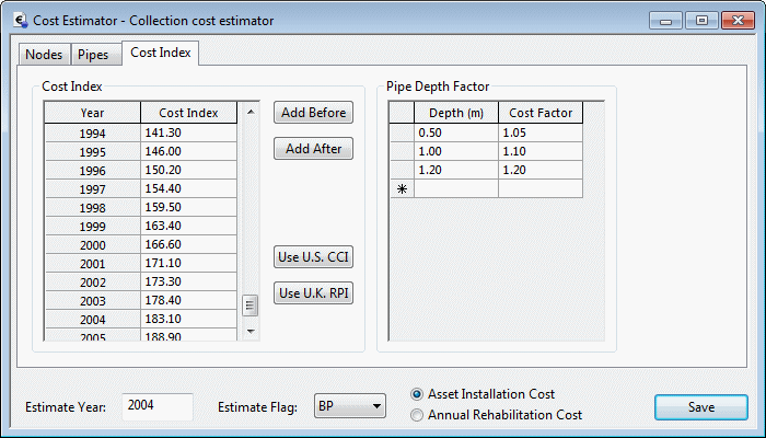

Cost Index Page
The Cost Index page provides information about changes in costs due to inflation or deflation over time. This is displayed in the grid, where the relative costs for each year may be specified.
Show me
Clicking on the Use U.S. CCI button fills the grid with data based on the U.S. Construction Cost Index.
The Use U.K. RPI button provides data from the UK Retail Price Index.
If using a different cost index system, just copy/paste the data onto the Cost Index Page grid.
Any Cost Index value in the grid may be modified by clicking in the cell and editing the value. Additional data may be added one year at a time, for years before or after the current the current data set. Click on the Add Before or Add After button and edit the new value to that required.
Note:
Years outside the standard range must be estimated manually.
The Pipe Depth Factor grid allows an additional cost factor to be specified for different pipe depths. Cost values calculated for a pipe will be multiplied by the appropriate cost factor for the pipe depth. A depth value of zero is given an implicit cost factor of 1.0. Cost factors are linearly interpolated between depth values.
