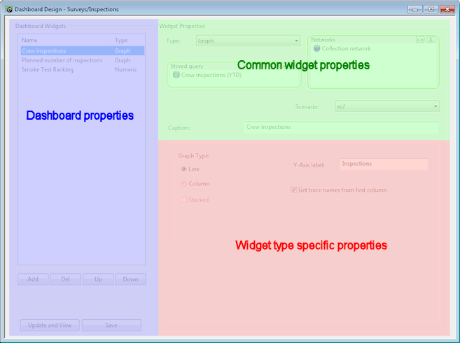

The Design View has 3 main panels as shown in the screenshot below.
Show me
Dashboard Design View areas

Area
Option
Dashboard properties
This area displays the dashboard widget list, by name and type.
Widgets can be added, removed and reordered here:
Add - Click this button to add a new widget. This displayed the Add Dashboard Widget dialog.
Del - Click this button to delete the currently selected widget.
Note:
Widget deletion is immediate (no prompt) so please use the Del button with care.
Up - Places the current widget higher up on the dashboard normal view.
Down - Places the current widget lower down on the dashboard normal view.
Update and View - updates the dashboard normal view with the latest network conditions and displays it.
Save - save the current widget configuration.
Common widget properties
The widgets are configured in this panel
Type - dropdown list of widget types. To change the widget type, select a different type in this dropdown list.
Stored Queries - drag an SQL query (or use the button to browse for a query) from the Explorer Window.
Networks - drag one or more asset networks or asset groups (or use the button to browse for them) from the Explorer Window.
Tip:
Please note that when Asset Groups are selected the Networks box will contain the networks within the Asset Groups rather than the Groups themselves.
Scenario - dropdown list of Scenarios, enabled when only one Network is selected. Select the scenario to be queried.
  • The selected scenario will be queried even if the SQL query refers to a different scenario, unless the SQL Query Scenario option is selected
  • If the SQL Query Scenario is selected, specific scenarios referred to in the SQL query will be used.
Caption - widget caption that will appear in the normal view.
Widget type specific properties
This panel is widget type specific.
The following tables summarise the options available for each widget type.
