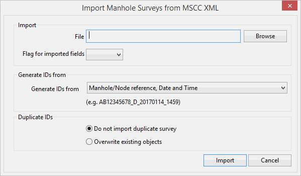

This dialog is used when importing manhole survey data from MSCC (Manual of Sewer Condition Classification) XML format files.
It is displayed when Import | Import Manhole survey data | Import MSCC XML manhole survey data is selected from the Network menu.
Show me
Dialog description
Option |
Description |
Import |
Select data to be imported:
Generate IDs From |
Set option for generating Manhole Survey IDs:
Duplicate IDs |
Set an option for importing surveys with duplicate IDs:
