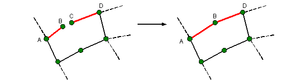

The Merge Nodes (Inline Proximity) rule is used to search for pairs of nodes connected to one pipe within a user defined Search Radius. If the nodes / pipes found satisfy defined parameters, the nodes will be merged, therefore joining the connected pipes.
If a fitting node is merged with another node type, the non-fitting node attributes will be kept in preference to the fitting node attributes.
Merge Nodes (Inline Proximity) example

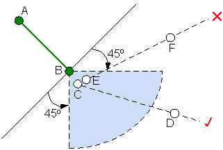

For merging to take place, in addition to satisfying the parameters specified in the Inference Editor, the following rules must be satisfied:
  1. Only one node found within Search Radius that is connected to only one pipe
  2. Pipe to be connected must be connected to two nodes
  3. Pipe to be connected must have difference in bearing greater than 45° (unless Ignore pipe intersection angles option is checked in the rule parameters)
When running the Merge Nodes (Inline Proximity) rule for Node B with Ignore pipe intersection angles unchecked:
  • If Node C is found, merging will take place as the difference in bearing between pipes A-B and pipes C-D is within the allowable limit.
  • If Node E is found, merging will not take place as the difference in bearing between pipes A-B and pipes E-F is outside the allowable limit.

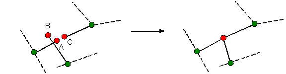

The Merge Nodes (Proximity) rule is used to search for nodes connected to one pipe within close proximity of one another and coalesces them into a single node.
InfoAsset Manager searches for nodes within a user defined Search Radius of each other. If the nodes found are within user defined diameter tolerance and elevation tolerance, the nodes will be coalesced into a single node.
Merge Nodes (Proximity) Example
Note:
Only nodes connected to a single pipe will be merged. To identify orphan nodes for further investigation, use the Connectivity Trace functionality.
