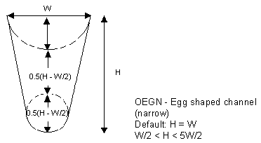

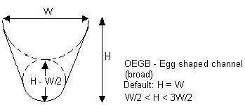

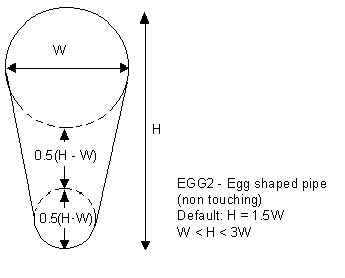

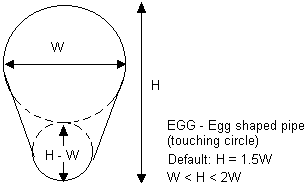

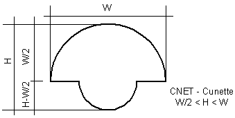

The table below provides details of the standard Pipe Shapes that are available from the Type dropdown list on the Pipe Shape Property Sheet. (See Pipe Shapes Editor for details).
Shape Type definitions are viewed and edited using the Pipe Shapes Editor in InfoAsset Manager.
Shape, Height and Width of individual pipes are edited in the Dimensions Page/ Section of the Pipe Property Sheet.
Pipe Shape Type |
Pipe Cross Section |
CIRC |
ARCH |
CNET |
EGG |
EGG2 |
OEGB |
OEGN |
OREC |
OT4:1OT2:1OT1:1OT1:2OT1:4OT1:6 |
Trapezoidal channel OTx:y, where x:y defines gradient of side slope of channel. |
OU |
OVAL |
RECT |
UTOP |
