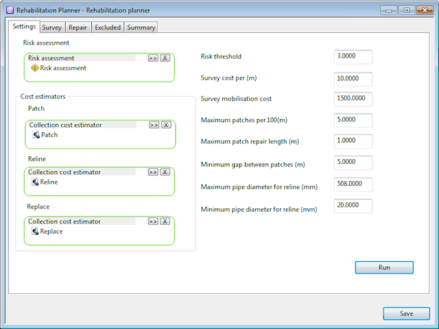

The planner requires the following items to be specified on the Settings page:
  • Risk Assessment object (used to calculate risk reduction for each repair option)
  • Cost Estimator objects (used to calculate costs of patching, relining and replacing pipes)
Adjust other settings on the Settings page if required and click the Run button. The Data Source Dialog will be displayed. Specify the selection of pipes to be assessed and click OK.

Settings Page
Show me
The Settings page is used to select the Cost Estimator objects used to provide costing information for different repair types and to define other settings as follows:
Parameter Description
Risk assessment Risk Assessment to be used to calculate risk reduction for each repair option.
Cost estimators
Cost Estimators used to provide costs for different types of repair:
  • Patch - used to provide costs for patch repairs
  • Reline - used to provide costs for relining of pipes
  • Replace - used to provide costs for replacement of pipes
Risk threshold Pipes with a Risk score below the specified Risk threshold will be excluded from the rehabilitation planning process.
Survey cost per (unit length)
Enter cost of carrying out a CCTV survey per unit length of pipe.
Used in calculation of survey costs on Survey page of planner.
Survey mobilisation cost
Fixed cost of carrying out a CCTV survey.
Maximum patches per 100 (unit length) Maximum number of patches allowed per 100 m/ft of pipe.
Maximum patch repair length Patch repair length, used in conjunction with Patch cost estimator when calculating cost of point repairs.
Minimum gap between patches Minimum allowable spacing between patch repairs.
Maximum pipe diameter for reline Maximum diameter of pipe to be considered for relining.
Minimum pipe diameter for reline Minimum diameter of pipe to be considered for relining.
Run button
Enabled when rehabilitation planner is associated with a network.
Click the Run button to assess pipes in the network and recommend surveys and repairs.

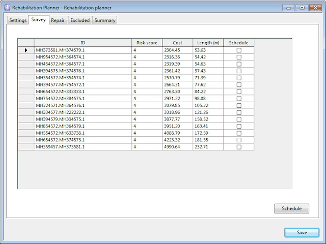

Survey Page
Show me
The Survey page lists pipes that will need to be surveyed in order to recommend a repair if necessary.
The grid lists all of the pipes with a Risk score above or equal to the Risk threshold specified in the Settings page that do not have an associated CCTV survey.
The pipes are listed in order of risk vs cost of survey, where cost is calculated by multiplying pipe length by the Survey cost per unit length specified in the Settings page.
To schedule CCTV surveys for selected pipes in the list:
  • Check the Schedule box for pipes to be surveyed
  • Click the Schedule button. The Create Scheduled Tasks Dialog will be displayed.
  • In the Create Scheduled Tasks Dialog:
    • Task Type to Create will be automatically set to CCTV survey
    • Create a new task for each selected item option will be automatically set if there are surveys selected
    • Click OK to schedule the surveys
A CCTV survey will be created for each selected pipe in the list.

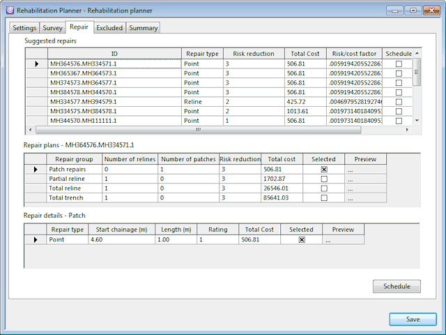

Repair Page
Show me
The Repairs page lists repair options for all assessed pipes that satisfy the following conditions:
  • Pipe Risk score equal to or greater than the Risk threshold specified in the Settings page
  • Pipe has associated CCTV Survey identifying defects with a structural score greater than zero
The page displays three grids:
  • Suggested repairs - details of repairs selected in the Repair plans and Repair details grids. Initially, this will display the repair plan and detail selected by the rehabilitation planner. If user changes are made to the selected repair plans and/or repair details, the values in the Suggested repairs grid will be updated according to the selection made.
  • Repair plans - repair options for the pipe currently selected in the Suggested repairs grid
  • Repair details - repair details for the repair plan currently selected in the Repair plans grid
To schedule repairs for selected pipes in the list:
  • Check the Schedule box in the Suggested repairs grid for pipes to be repaired
  • For each pipe marked to be Scheduled, select the Repair plans and the Repair details to be scheduled.
    • Task Type to Create will be automatically set to Pipe repair
    • Create a new task for each selected item option will be automatically set if there are repairs selected in the Suggested repairs grid
    • Click OK to schedule the repairs
A pipe repair will be created for each selected repair detail.
Suggested repair grid
The Suggested repair grid lists the pipes that repairs are recommended for and values for selected Repair details fomr selected Repair plans.
Column Description
ID Pipe ID
Repair type
The Repair type field is set according to the Repair plans and Repair details selected for the pipe:
  • Point - patch repair is selected
  • Reline - reline repair is selected
  • Trench - trench repair is selected
  • Mixed - more than one repair type is selected
Risk reduction
The difference between the pipe's current Risk score and the risk score after repair (determined from Risk Assessment specified in Settings page).
Total cost Total cost of selected Repair details for selected Repair plans.
Risk/cost factor
Calculated as Risk reduction/Total cost.
The Risk/cost factor is used to select a recommended repair option.
Schedule Check the Schedule box to schedule selected repairs for the pipe when using the Schedule button.
Repair plans grid
The Repair plans grid lists repair plan options for the currently selected pipe in the Suggested repair grid. The cost information in the grid is updated according to the Repair details selected for the repair plan.
Column Description
Repair group
The repair group types are:
  • Patch repairs - patch part of pipe
  • Partial reline - reline part of pipe
  • Total reline - reline entire pipe
  • Total trench - pipe replacement
Number of relines
Number of reline repairs required to repair pipe.
Number of patches Number of patch repairs required to repair pipe.
Risk reduction The difference between the pipe's current Risk score and the risk score after repair (determined from Risk Assessment specified in Settings page).
Total cost Total cost of selected Repair details for plan.
Selected Check the Selected box to schedule repairs for the pipe when using the Schedule button.
Preview Displays a long section view of the pipe and pipe repair.
Repair details grid
The Repair details grid lists the repair options for the currently selected plan in the Repair plans grid. The values in the grid are editable to allow adjustments to be made to the values calculated by the rehabilitation planner.
Column Description
Repair type
The repair types are:
  • Reline - reline pipe
  • Trench - replace pipe
Start chainage Location along pipe at which repair starts
Length Length of repair
Rating Structural condition score if repair were to be carried out.
Total cost Total cost of repair.

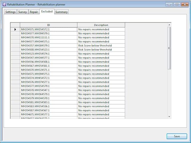

Excluded Page
Show me
The Excluded page lists the pipes that have no recommended repairs or surveys and lists the pipes for which relining repairs have been excluded due to relining constraints specified on Settings page.

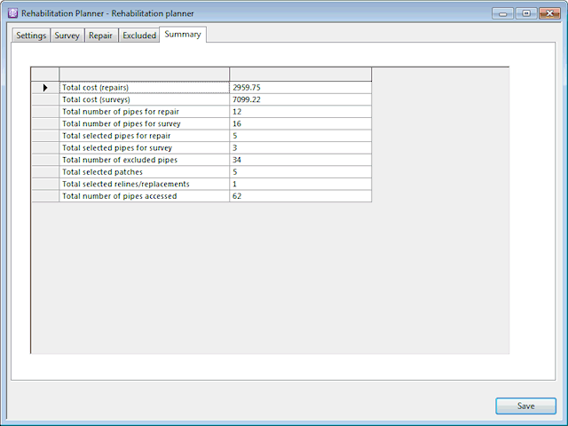

Summary Page
Show me
The Summary page lists the following information:
Field Description
Total cost (repairs)
Total cost of repairs selected for Schedule in the Suggested repairs grid on the Repair page.
Total cost (surveys) Total cost of surveys selected for Schedule on the survey page.
Total number of pipes for repair Number of pipes listed in the Suggested repairs grid on the Repair page
Total number of pipes for survey Number of pipes listed on the Survey page.
Total selected pipes for repair Number of pipes with Schedule box checked in the Suggested repairs grid on the Repair page.
Total selected pipes for survey Number of pipes with Selected box checked in the Suggested repairs grid on the Survey page.
Total number of excluded pipes
Number of pipes listed on Excluded page
Note that a pipe may be excluded from relining due to diameter, but may also be included for other repair types.
Total selected patches Number of repairs with Repair type of POINT selected on Repair page
Total selected relines/replacements Number of repairs with Repair type of Reline or Trench selected on Repair page
Total number of pipes accessed Total number of pipes assessed by the rehabilitation planner.
