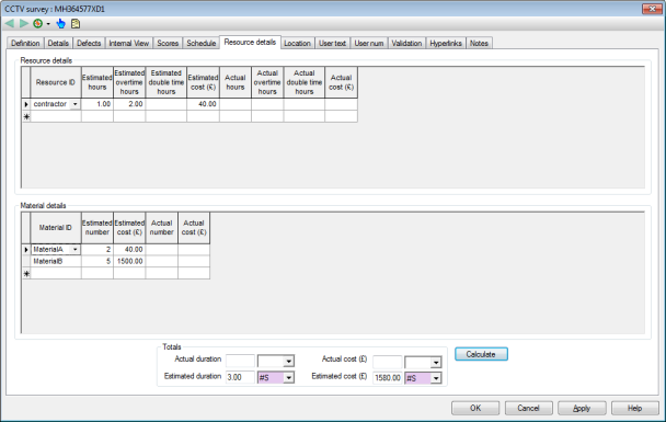

- Unless the Review task properties before creation option is unchecked, a tabbed property sheet with a Resource Details tab is displayed for the scheduled task to be created.
- Enter details (estimated worked hours for resources and estimated number and cost for materials) onto this tab.
- Click Calculate to display the calculated values in the Totals section of the Resource Details tab. Click OK to close the Resource Details tab and automatically update the calculated values in the task property sheet.
Estimated values (sum of estimated hours times the corresponding rates, plus any fixed cost for resources and materials) get calculated along with the estimated total duration and actual cost according to the following rules:
- Resource and Material IDs that are blank or do not exist are ignored.
- Calculated values are entered into blank fields.
- If there is a risk of overwriting a value, the software will prompt the user to make a decision. If the decision of not overwriting the value is taken, where costs are already present on the grid, they are used in preference to the calculated cost.
- Calculated costs and durations will have the #S flag set to indicate they have been calculated by InfoAsset Manager.
Show me
