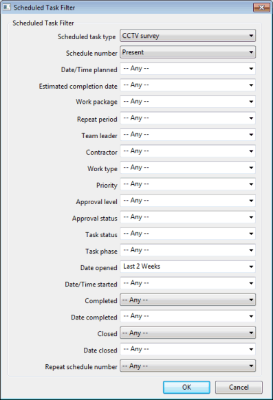

Filter scheduled tasks
A Grid Window of scheduled tasks filtered according to values in schedule fields can be displayed.
To display a filtered Grid Window of scheduled tasks:
- Select Scheduling | Filter
scheduled tasks from the Network menu or click the
button on the Scheduling Tools Toolbar. The Scheduled Task Filter dialog will be displayed.
- The Scheduled Task Filter dialog lists the fields that are present on the Schedule Page of the task property sheet. Select values in the fields to filter by and click OK to display a Grid Window of task objects.
Only tasks with values matching those selected in the task filter dialog will be displayed in the Grid Window.
