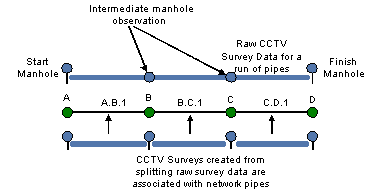

Splitting CCTV Survey ExampleA CCTV Survey has been carried out for a run of pipes A-D. The Split CCTV Surveys tool creates three new CCTV Surveys that are each associated with a single network pipe. |

Intermediate nodes
The Split CCTV Surveys tool checks that the number of intermediate nodes in the original CCTV survey corresponds with the number of intermediate network nodes between the start and finish manholes of the survey.
- The CCTV Survey Defects with a code matching that of a node observation code listed in the Split CCTV Surveys dialog is considered to be an intermediate node.
- If Check for intermediate node observations in the Split CCTV Surveys dialog is ticked, a check will be made that each survey intermediate node is within the user specified distance tolerance of a network node.
