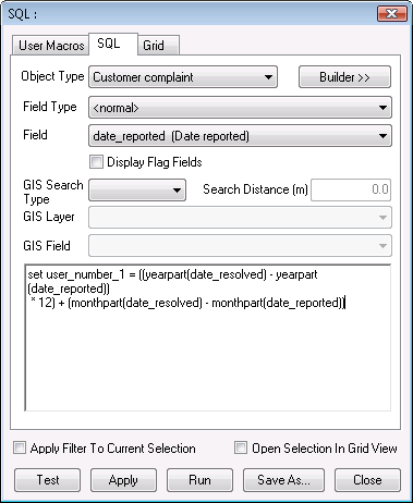

The Query
set user_number_1 = ((yearpart(date_resolved) - yearpart(date_reported)) * 12) + (monthpart(date_resolved) - monthpart(date_reported))
Show me
Explanation and Examples
We are putting the calculating value into the customer complaint user number field 1. In the explanation below we will use the following example dates:
1. Date Reported = 1/6/2005 – Date Resolved = 1/4/2006
2. Date Reported = 1/6/2005 – Date Resolved = 1/4/2007
3. Date Reported = 1/6/2005 – Date Resolved = 1/8/2006
4. Date Reported = 1/6/2005 – Date Resolved = 1/8/2007
5. Date Reported = 1/6/2005 – Date Resolved = 1/6/2006
6. Date Reported = 1/6/2005 – Date Resolved = 1/10/2005
7. Date Reported = 1/6/2005 – Date Resolved = 25/6/2005
The yearpart(date_resolved) – returns the year number when the complaint was resolved.
The yearpart(date_reported) – returns the year number when the complaint was reported.
The monthpart(date_resolved) – returns the month number when the complaint was resolved.
The monthpart(date_reported) – returns the month number when the complaint was reported.
Set user_number_1 = ((2006 - 2005) * 12) + (4 - 6) = (1 * 12) + -2 = 10
Set user_number_1 = ((2007 - 2005) * 12) + (4 - 6) = (2 * 12) + -2 = 22
Set user_number_1 = ((2006 – 2005) * 12) + (8 - 6) = (1 * 12) + 2 = 14
Set user_number_1 = ((2007 – 2005) * 12) + (8 - 6) = (2 * 12) + 2 = 26
Set user_number_1 = ((2006 – 2005) * 12) + (6 - 6) = (1 * 12) + 0 = 12
Set user_number_1 = ((2005 – 2005) * 12) + (10 - 6) = (0 * 12) + 4 = 4
Set user_number_1 = ((2005 – 2005) * 12) + (6 - 6) = (0 * 12) + 0 = 0

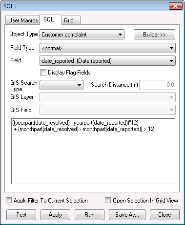

If we would rather select any complaint object that has more than 12 months from report to resolution we can modify the SQL to:
((yearpart(date_resolved) - yearpart(date_reported))*12) + (monthpart(date_resolved) - monthpart(date_reported)) > 12
