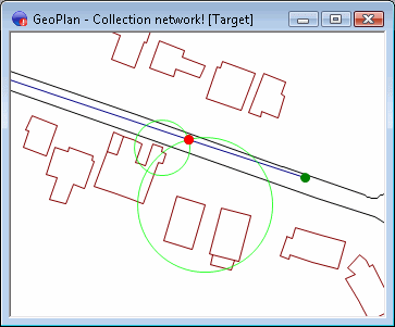

InfoAsset Manager will draw a circle with radius as specified on the Add Triangulation Point Dialog and centre at the location clicked on in the GeoPlan Window.
Alternatively, a triangulation point can be added to the current GeoPlan by pressing the T key on the keyboard. This will display the Add Triangulation Point Dialog. InfoAsset Manager will draw a circle with radius as specified on the Add Triangulation Point Dialog and centred at the current cursor location.
Snapping functionality is available to allow snapping of the centre point of the circle to a GIS background layer vertex.With Snapping Mode active, press the g key on the keyboard to toggle GIS snap mode on or off.
As many circles as required may be added to the GeoPlan Window. The crossing point of the circles indicates the location of the surveyed object.
