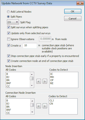

To update the network from CCTV Survey data:
- With the network open, select Update
from CCTV surveys from the Network
menu. This displays the Update
Network from CCTV Survey Data dialog.
Show me
- In this dialog:
- Select whether the node is to be added as a lateral node or whether it is to be inserted into the pipe
- Select the defect codes at which nodes are to be created in the Node Insertion and Connection Node Insertion sections
- Check Update only from selected surveys to apply updating to the current selection of CCTV Surveys only
- Check Ignore Observations to prevent creation of nodes at the location of defect codes within the specified distance of a node. (Note that when creating connection pipe stubs, a connection pipe stub will be created if a defect within the specified distance has a clock position that creates the connection stub on the side of the pipe that does not already have a nearby connection pipe.)
- If using the Split Pipes
option, the following options can also be used:
- Select a Split Flag to be applied to pipe fields that are recalculated due to splitting (e.g. pipe length)
- Check Split surveys when splitting pipes to automatically split associated CCTV Surveys.
- Check Create a [x] m connection pipe stub to create a connection pipe of length specified where suitable Clock at and Clock to values are available for the defect. When using this option, the following options can also be used:
- Check Stop connection pipe stub early if a property is encountered to terminate the connection pipe stub if it reaches the boundary of a property before it reaches the length specified
- Check Create connection node at end of connection pipe stub to create a connection node at the upstream end of the connection pipe stub.
- Click OK to carry out the update.
