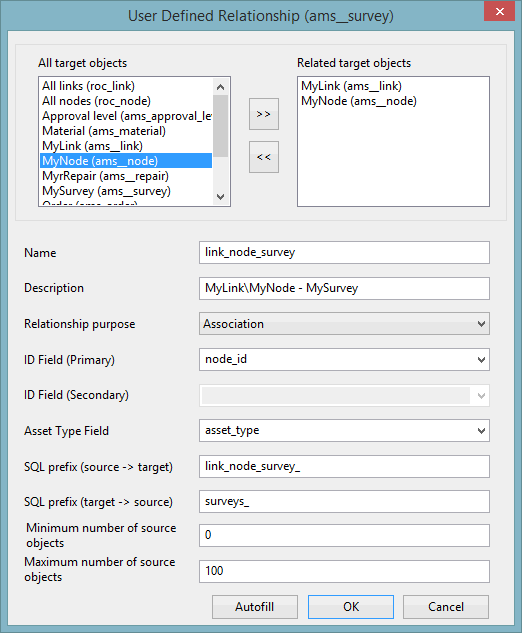

The relationship in the screenshot above is being specified between a user defined survey type (source) defined for Asset networks (see ams__survey in dialog titlebar) and two user-defined object types (targets).

Let us imagine we are creating a relationship between a user defined survey type called MySurvey (source) which is valid for Asset networks, and two user defined objects, a link object type called MyLink and a node object type called MyNode (target).
The rightmost column of the table contains the suggestions for a worked example.
Field name Suggestion Example
Name
targetobjecttype_sourceobjecttype
link_node_survey
Description
target - source
MyLink\MyNode - MySurvey
Relationship purpose
No suggestion. It is up to the user to select the relationship purpose.
Empty
Select a relationship purpose.
ID Field (Primary) / US ID Field
targettype_id
(For Collection Pipe relationships - pipe_us_id)
node_id or link_id
ID Field (Secondary) / DS ID Field
n/a
(For Collection Pipe relationships - pipe_ds_id)
n/a
Asset Type Field / Link Suffix Field
For Asset relationships - asset_type
For Collection Pipe relationships - link_suffix
asset_type
SQL prefix (source -> target)
targettype_sourcetype_
link_node_survey_
SQL prefix (target -> source)
sourcetypeplural_
surveys_
The plural is used as this will allow us to find the many surveys associated with a node or link.
