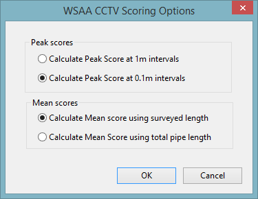

This dialog is used to specify the method to be used for calculating peak and mean scores when using a WSAA CCTV Standard.
It is displayed when you click WSAA Options on the Standards and Choice Lists dialog.
Dialog description
Select a method for calculation of CCTV survey Structural peak score and Service peak score:
  • Calculate Peak Score at 1m intervals: the pipe is broken into discrete lengths of 1m. The structural/service score is calculated for each 1m length and the maximum of these values taken to be the peak score.
  • Calculate Peak Score at 0.1m intervals: the structural/service score is calculated for 1m lengths of pipe on a rolling basis using 0.1m increments to determine the start of each metre length. The maximum of these values is taken to be the peak score.
Select a method for calculation of CCTV survey Structural mean score and Service mean score:
  • Calculate Mean score using surveyed length: CCTV survey Structural/Service mean score is calculated as Structural/Service total score divided by survey length.
  • Calculate Mean Score using total pipe length: CCTV survey Structural/Service mean score is calculated as Structural/Service total score divided by Total length.
