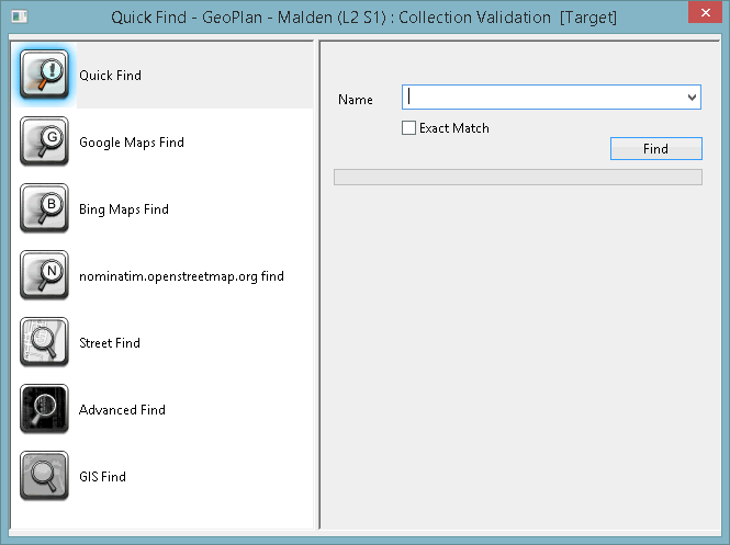

Quick Find
This the view displayed by default and is a useful option if you know exactly which object(s) you are looking for.
Enter the full or partial name of the object(s) in the Name box. (Previous searches that have been made since this instance of the application was opened may be selected from the dropdown.)
Click Find to search for all objects with IDs that include the string typed in the Name box.
To search for an object with an ID that exactly matches the string entered in the Name box, check the Exact Match box.

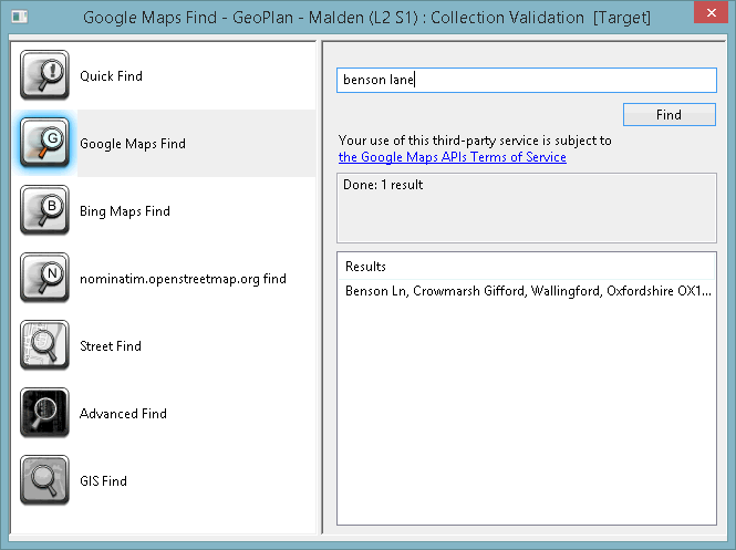

Google Maps Find
A location can be found by specifying its full or partial address using the Google Maps Find option.
Click Google Maps Find in the Geoplan Find dialog.
Enter the full or partial address of the location in the search field.
Click Find to search for the address. Any messages are displayed in the read-only message pane and the search results are displayed in the Results pane.
Click on the address in the Results pane and the GeoPlan will centre on the selected address.

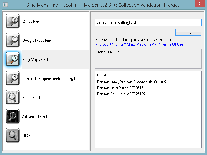

Bing Maps Find
A location can be found by specifying its full or partial address using the Bing Maps Find option.
Click Bing Maps Find in the GeopPan Find dialog.
Click Find to search for the address. Any messages are displayed in the read-only message pane and results of the search are displayed in the Results pane.
Click on an address in the Results pane and the Geoplan will centre on the selected address.

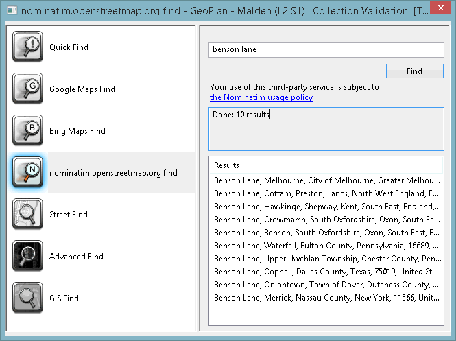

Nominatim Maps Find
A location can be found by specifying its full or partial address using the 'Nominatim' Find option.
Note: The title of this option is based on the URL for the Nominatim application provider selected in the geocoding options for the GeoPlan.
Click 'Nominatim' Find in the GeoPlan Find dialog.
Click Find to search for the address. Any messages are displayed in the read-only message pane and the results of the search are displayed in the Results pane.
Click on an address in the Results pane and the GeoPlan will centre on the selected address.

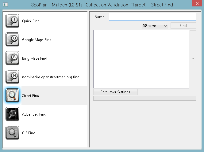

Street Find
Use the Street Find to search for a specific road / street on your network.
Click Street Find in the GeoPlan Find dialog.
  • Click Edit Layer Settings to specify the GIS background layer and field that the search is to be carried out on.
  • A full or partial road name should be entered in the Name box.
  • It is possible to set the maximum number of returned results by using the related dropdown list. The search will stop once this limit has been reached.
  • Layer settings (Layer and Field) can be saved and edited by using the Save (or Edit) Layer Settings button.
Note: A GIS Find search can be slow. The search is performed inside the GIS package, not within InfoAsset Manager. It is therefore recommended to select a maximum number of items to return that is the smallest possible.

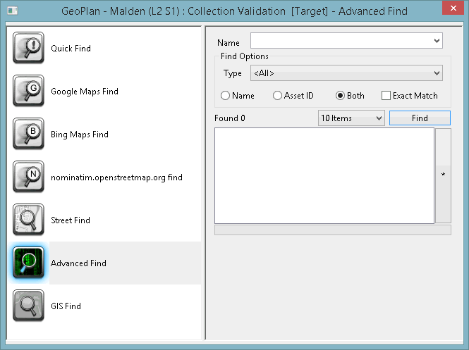

Advanced Find
Use the Advanced Find to search for network objects using a string that contains wildcard characters.
Click Advanced Find in the GeoPlan Find dialog.
  • A partial or full object name or asset ID can be entered in the Name box. (Previous searches that have been made since this instance of the application was opened may be selected from the dropdown list.)
  • Object names, asset IDs or both can be searched.
  • You can specify which type of objects to search by using the Type dropdown. The search will stop once this limit has been reached.
  • It is possible to set the maximum number of returned results by using the related dropdown.
Click Find to list objects with IDs that include the string typed in the Name box.
Check Exact Match to search for objects with ID that exactly matches the string entered in the Name box.
