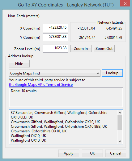

Go To XY Coordinates Dialog
This dialog allows you to centre the GeoPlan View on a specified point, and zoom in or out on that point if required. It also lets you use a selected online map application to find the address of the specified point.
It is displayed when you click on the Find XY button on the GeoPlan Tools Toolbar or select Go to XY coordinate from the GeoPlan menu .
Dialog description
Item Description
Projection The read-only current map projection for the GeoPlan.
X Coord Chosen X Coordinate. The default is the centre of the current view.
Y Coord Chosen Y Coordinate. The default is the centre of the current view.
Zoom Level The selected zoom level. The default is the current zoom level.
Network Extents The read-only maximum and minimum X and Y extents of the network.
Zoom In
Adjusts the zoom level.
Each click doubles or halves the zoom level.
Zoom Out
Address lookup Finds the address for the chosen location (X,Y coordinates) using a web map application.
Item Description
Show / Hide Shows or hides the address lookup fields
Web map application A dropdown of the available online web applications. The list is populated with the applications specified in the Online Find Options (Geocoding) dialog.
Lookup Finds addresses for the chosen X,Y coordinates, which are listed in a read-only pane.
Tip: You can use the Windows® Copy option to copy an address from the list.
Apply Applies changes without closing the dialog.
OK Saves any changes and closes the dialog.
Cancel Discards any changes and closes the dialog.
