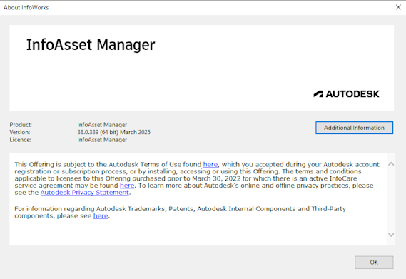

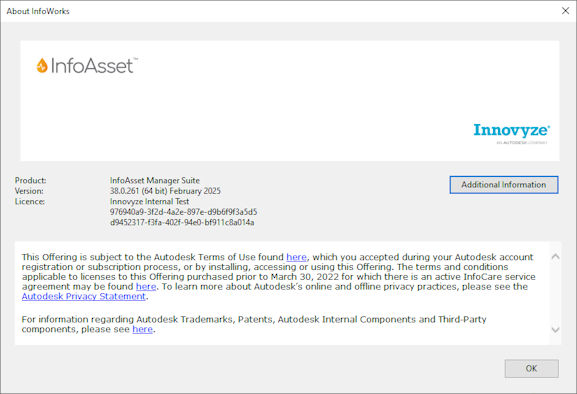

The About InfoWorks box displays usage agreement information about your current InfoAsset Manager installation, as well as the version build number of the installed software and the licence name, which is read from the server.
The About Box is displayed by selecting About InfoAsset Manager from the Help menu.
An example of the About InfoWorks box when using InfoAsset Manager with an Innovyze licence:
An example of the About InfoWorks box when using InfoAsset Manager with an Autodesk licence:
