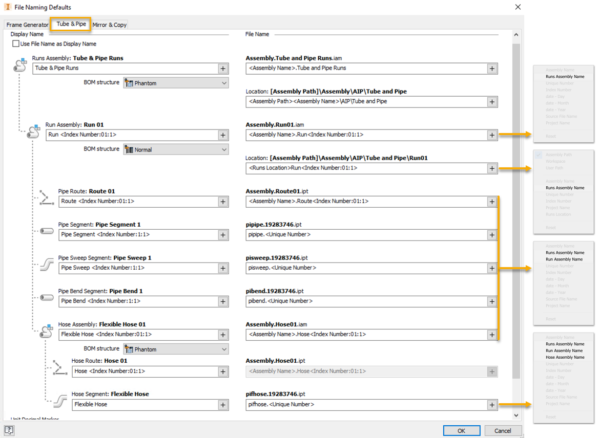

Tube & Pipe Enhancement
The File Naming Defaults dialog box is enhanced with the following attributes:
  • Runs Assembly Name
  • Run Assembly Name
  • Hose Assembly Name
While manually defining Runs assembly file names, use the new attributes for the child components to inherit the file name.
For more information, see To Customize the Tube & Pipe Folder Structure.
