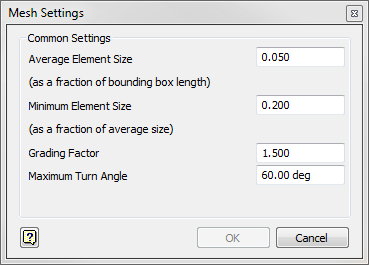

Mesh Settings
Use the Mesh Settings to manually control the Average Element Size, Minimum Element Size, Grading Factor, and Maximum Turn Angle.
- On the Analysis Tab > Mesh panel, click
Mesh Settings. This opens the Mesh Settings dialog. - Adjust the Common Settings as necessary to achieve the appropriate mesh.
Note: The Average and Minimum Element Sizes must be represented as a fraction (less than or equal to one). The Grading Factor must be between 10 and 1, the Maximum Turn Angle must be between 90 and 1 degrees. Adjusting the Mesh Settings will modify the Mesh Resolution specified in the Shape Generator Settings.
