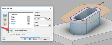

Create a Ruled Surface
Create a ruled surface to add extensions to complex surfaces, create parting surfaces, or to add a drafted face that follows a direction vector.
  1. Click 3D Model tab Surface panel Ruled Surface .
  2. In the dialog box, do one of the following:
    • Select Normal to create a surface normal to the selected edge.
    • Select Tangent to create a surface tangent to the selected edge.
    • Select Vector to create a surface that follows a selected face, work plane, edge, or axis.
  3. In the graphics window, select the edges for creating a ruled surface. If necessary, use Select Other to cycle through selectable geometry, and then click to select.
    Note: Sketch edges are not valid for ruled surface edge selection.
  4. Optionally, clear the check box to disable Automatic Edge Chain.
  5. Optionally:
    • In the dialog box Selection panel, select the alternate face icon to change the source reference face for the edge.
      ![](../../images/RuledSurface_Alt by edge.png)
    • To change the source reference face for all selected edges, click Alternate All Faces.
Note: The alternate face option is valid for selected edges that share two faces.
  1. Optionally, pick Flip to change the direction of the surface.
  2. For the Sweep option, click a face, an edge, or an axis to specify the direction Vector.
  3. Set the distance to extend the surface.
  4. Optionally, specify an angle for the surface.
  5. Click OK to finish.
