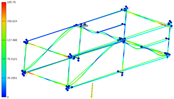

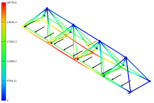

When you activate a result in the browser the color maps on all beams is presented together with a color chart. The Color bar respects the settings of specified result type (quantity). Beams display at specified scale showing color charts per calculated results.

  • Minimum and maximum values that quickly show the locations of load extremes.
  • A deformation scale that allows you to amplify the effects of loads so you can easily see the impact of loads.
  • Volume plots, both smooth shaded and contour.
  • Animation of the displacement.
