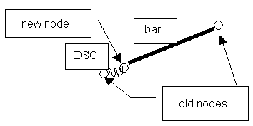

For any beam, for which you defined any type of analysis, with the following releases:
  • Regular
  • Unilateral
  • Elastic
  • Elastic and unilateral
The following operations are performed:
  • A new node is generated in the structure when the structure model is generated.
  • The input element with the release is modified. The new node replaces the old one in the element (the old node remains in the other structure elements).
  • Between the old and the new node, Frame Analysis creates the DSC element (Discontinuity). See the following image:
The DSC element is a 2-node element, where the nodal forces are generated according to the following formula:
