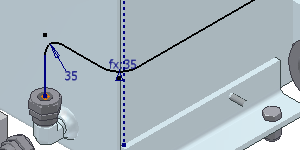

A derived route is created based on a 3D sketch in the assembly. A base sketch can be created based on geometry in any part that exists in the standard Autodesk Inventor assembly or tube and pipe runs assembly. It must be outside any routes. Using 3D sketches to create derived routes, the resultant derived routes contain exactly the same geometry as selected from the base sketch.
3D sketches can be outside a part, for example, you may want to create separate sketch lines that are only parallel or perpendicular to geometry in the part. To make use of geometry in a part, apply constraints to a base sketch between sketch elements and geometry in the part. 3D constraints, such as Parallel and Perpendicular, are significant for orthogonal tube and pipe design systems. Valid base sketches include:
