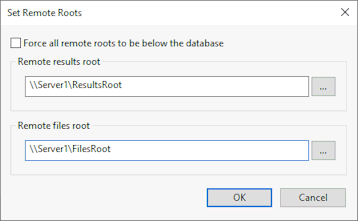

This dialog is used to set the directories to which data saved outside of the on-premise database will be written.
It is displayed when you select the Database management
Set remote roots option from the File menu.
See Remote Roots for further information.
Dialog description
Item |
Description |
Force all remote roots to be below the database |
Available for Standalone databases only. Check this box to store all remote root data in the folder containing the database. |
Remote results root |
InfoWorks ICM simulation results saved to the server will be stored in the remote results root.
Enter the path of the folder to be used as the remote results Root or use
Remote files root |
If background map layer files or hyperlinked files are stored in the remote files root; Layer List and hyperlinked file paths will be stored relative to the remote files root. Enter the path of the folder to be used as the Remote Files Root or use
to browse for a folder.
