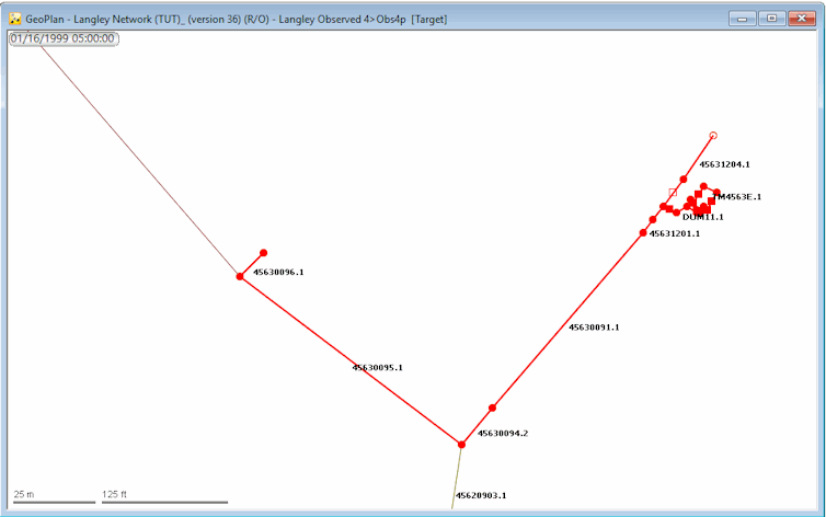

  5. Locate node '45630095' on the North East side of the network (to the south of the pump) and select all the pipes leading to the outfall ('45631203') node. You can use the selection tool () while holding the Ctrl key to select multiple objects.
    Selected Items on the GeoPlan

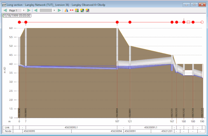

  6. Once selected, click the (Long section) tool to display the selected area in the Long Section view.
    Geoplan Selection in Long Section View

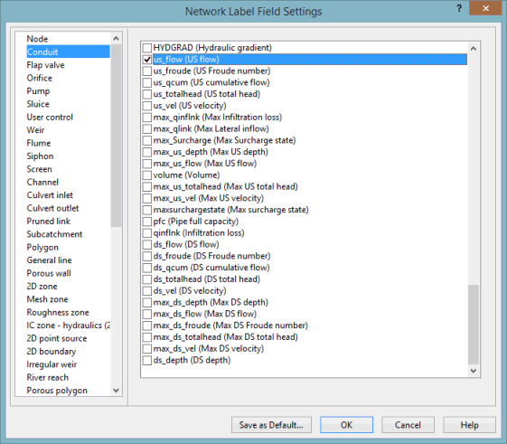

    1. In the Content tab, click the Field Settings button. The Network Label Field Settings dialog is displayed.
    2. For this example, select the following parameters from this dialog:
      • flooddepth (Do not select flood_depth_1 or flood_depth_2) for Node
        Network Label Field Settings for Node
      • us_flow for Conduit
        Network Label Field Settings for Link
    3. Click OK in both the dialogs to close the windows.

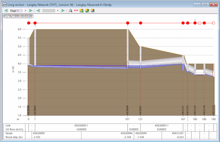

  8. The labels are now shown in the boxes at the bottom of the Long Section view:
    Long Section Results Selection With Labels
  9. Click the button to play the simulation. As the replay progresses you will be able to see the water level changing in the Long Section view. You can run the simulation and pause it at a specific time to observe values at that particular time.
    Playing the simulation in the Long View
