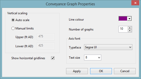

The Conveyance Graph Properties dialog enables you to change the display of the conveyance graph. The window is displayed by right-clicking on the graph displayed in the Conveyance Graph Window, and selecting Properties from the popup menu.
The Conveyance Graph Properties Dialog
Using the Conveyance Graph Properties dialog you can:
- Set the vertical scale for displaying the graph. Choosing Auto scale allows InfoWorks ICM to set the vertical scale or you can choose Manual limits to specify the Upper and Lower limits (in feet AD) to be used for the vertical scale.
- Choose whether or not to display horizontal grid lines on the graph by checking or unchecking the Show horizontal gridlines box.
- Set the colour to be used to display the conveyance curves by choosing a colour from the Line colour drop-down colour chart. Note that the previous displayed curve is automatically shown in a faded version of the selected colour.
- Set the maximum number of conveyancing curves, up to 10 (default), that can be displayed on the same view in Number of Graphs. Note that 6 curves are generated for bridge sections, (US link, US ridge, bridge deck (contraction), bridge deck (expansion), DS bridge and DS link sections), therefore setting the Number of Graphs to more than 6 will still only display 6 curves for bridge sections.
- Select the font type and size used to display the Axis text on the graph.
When you have set the properties, select either Apply to apply the changes, Ok to apply the changes and close the Conveyance Graph Properties dialog, or Cancel to cancel the changes and close the dialog.
