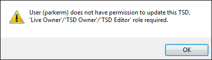

Permissioned dialogs or options will be read-only for users who have not been assigned the required roles. Alternatively, a warning message similar to the one shown below is displayed if users attempt to perform an action for which they do not have the required permission:
User Permissions warning message
