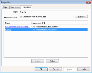

The list of hyperlinks for a database item or network object is managed on the Hyperlinks Page of the object's Property Sheet. This page is used to add, edit and access hyperlinks. Hyperlinks for network objects can also be accessed from the GeoPlan Window or the network object grid.

- Database items - right-click on the database item and select Properties from the popup menu to display the Properties dialog for the item. Click on the Hyperlinks tab of the dialog.
- Network objects - open the Property Sheet for the object and click the Hyperlinks field button.
Add hyperlinks
Hyperlinks can be added by typing in a path name or browsing for a file:
- Click just below the last entry in the Hyperlinks list so that there are no selected links in the list. The Name and Filename or URL boxes should now be blank. Alternatively, click the Insert button.
- Click the Browse button, and search for the file you want on a local or network drive. Select the file and Click Open. Alternatively, type in the full path to the file if you know it.
- The software uses the file path to provide a name. If you want a more descriptive name, edit the Name field.

To edit hyperlinks on the Hyperlinks Page of the property sheet
- Click the hyperlinked item in the Hyperlinks list. This displays the name and linked data path in the Name and Filename or URL boxes at the top of the page.
- Change either the name or the location using these boxes.
