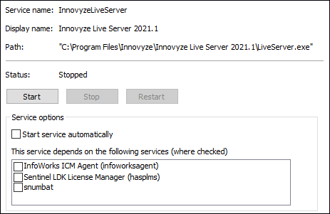

The Service property page is automatically opened when InfoWorks Server Configuration Manager is started. The content of the page is dependant on which Windows service is currently active. The screenshot below shows the Live Server Windows Service page.
Live Server - Service Page
