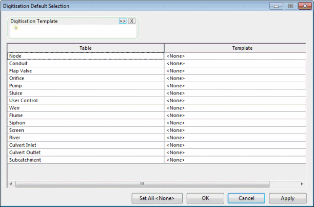

Digitisation Default Selection dialog
This dialog is used to select the templates stored in a digitisation template to be used for setting default values when new network objects are created.
The dialog is displayed when Digitisation defaults is selected from the Tools menu.
The settings in this dialog are applied when the Initialise new objects with digitisation default values box on the General Page of the GeoPlan Properties And Themes dialog has been checked.
Item Description
Digitisation Template box The digitisation template containing the templates to be used for setting default values. You can drag a digitisation template to this box from the Model Group window, or you can use the Browse button to find and open one.
Table / Template grid
The template to be used for each network object may be mapped to an object type by selecting from the dropdown list in the Template column of the grid. Each dropdown list contains only those templates from the selected digitisation template that correspond with the object type in the row.
Set All <none> Use to clear existing mappings and set all fields to <none>. Template mappings are remembered from previous use of the dialog.
OK Use to apply changes made to template mappings and dismiss the dialog.
Cancel Use to undo any changes made since the last time changes were applied and to exit the dialog.
Apply Use to apply all changes made to template mappings.
