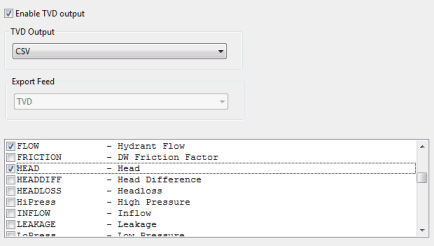

TVD page
Used to set up export options for time-varying data. Show image
| Option | Application | Description |
Enable TVD output |
Enable the export of TVD data by checking this box. |
TVD Output |
Enabled when TVD output is enabled |
Select the type of output to which you want to export the time-varying data (CSV or Database) |
Export Feed |
Enabled for export to database only |
Select the live data export feed to export. This dropdown list is automatically populated with live data export feeds that have an export type of Time-varying results. (Export type is assigned in the Live Data Export View page of the live data object). |
Attribute list |
This list contains the most common TVD results fields for all network objects. Select the attributes to be exported by checking the adjacent boxes. Note: You are still allowed to select attributes even if TVD output is disabled. In this case, selection will be ignored and no TVD results will be exported. CSV export: TVD export files are placed in a subdirectory of the output folder (specified in the General page of the Export Style dialog) called TIMESTEP. File names are of the type \$Prefix_$Type_$Result.CSV where $Prefix is defined in the export style dialog General page, $Type is the table name such as wn_node and $Result is the type of result, for example Pressure. |

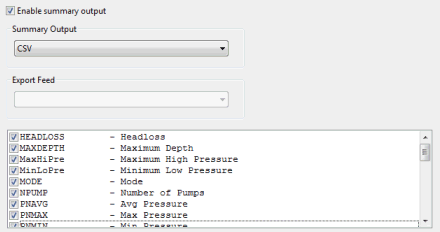

Summary page
Used to set up export options for summary results. Show image
Enable summary output |
Enable the export of summary data by checking this box. |
Summary Output |
Enabled when summary output is enabled |
Select an output format (SHP, MIF, CSV or Database). |
Export Feed |
Select the live data export feed to export. This dropdown list is automatically populated with live data export feeds that have an export type of Summary results. (Export type is assigned in the Live Data Export View page of the live data object). |
Summary parameters |
This list contains all the Summary parameters for all network objects. Select the parameters to be exported by checking the adjacent boxes. Note: You are still allowed to select attributes even if Summary output is disabled. In this case, selection will be ignored and no Summary results will be exported. CSV export: Summary export files are placed in a subfolder of the output folder called SUMMARY and are split into individual files according to object type. File names are as follows: \$Prefix_$Type.CSV, \$Prefix_$Type.SHP or \$Prefix_$Type.MIF where $Prefix is defined in the export style dialog General page and $Type is the table name such as wn_node. |
