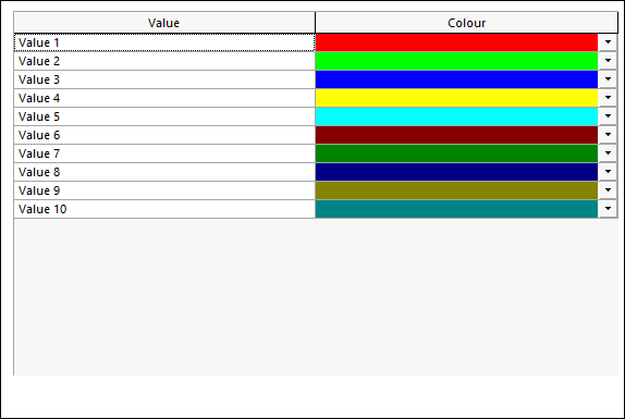

Use this page to view and change the default colours used by InfoWorks WS Pro when setting up a theme on attributes that have a number of distinct values.
The page is displayed when you choose Tools | Options and select the Theme Default Colours page.
Up to ten default colours can be defined.
Clicking the drop control to the right of a colour displays a colour palette, from which a new colour can be selected. If you click the Custom button, the standard Windows Colour dialog is displayed, from which a new colour can be generated.
