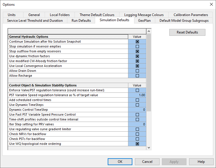

Options dialog - Simulation Defaults page
This page allows the setting of default values for simulation parameters. The default values will be set in the Schedule Hydraulic Run view when a new run is created.
The page is displayed by choosing Tools | Options and selecting the Simulation Defaults tab.
Note: Colors are used to indicate whether defaults are in use. Blue indicates the default setting. White indicates that a new setting is in place.
Item Description
Description (column)
Option Description Default
General Hydraulic Options
Continue Simulation after No Solution Snapshot
Determines whether the simulation stops or continues if the engine fails to reach a solution within the maximum number of iterations specified in the Schedule Hydraulic Run view.
If the simulation is to continue, a warning is displayed in the Run Control window. This warning is also listed in the log results for the simulation.
Yes
Stop simulation if reservoir empties
Determines whether the simulation stops or continues if a reservoir depth falls below minimum operating level.
If the simulation is to continue, a warning that the reservoir is empty is displayed in the Run Control window. This warning is also listed in the log results for the simulation.
The subsequent behaviour of the simulation will depend on the setting of the Stop outflow from empty reservoirs option. See below for details.
No
Provides the option to stop outflow from a reservoir when the depth in the reservoir falls below minimum operating level. Will only come into operation if the Stop simulation if reservoir empties option is set to "No".
If the value is set to "No", InfoWorks WS Pro will continue computation assuming that the reservoir water level never falls below the reservoir minimum operating level. The amount of water needed to maintain head at that level is calculated and reported as a "Deficit" result.
If left as default "Yes", outflow from the reservoir will be stopped at the next timestep after the reservoir falls below minimum operating level. Any demand or transfer supplied solely by the empty reservoir will become isolated. The isolated demand/transfer will be cancelled until the reservoir depth rises to above minimum operating level.
IMPORTANT: A transfer node acting as an inflow is treated as a (negative) demand and will be isolated and cancelled.
Yes
Use dynamic friction factors
If "Yes" (default), InfoWorks WS Pro converts the Hazen Williams roughness coefficient C, or the Colebrook-White roughness coefficient k, to the equivalent Darcy-Weisbach factor depending on the Reynolds number for flow in each pipe. The conversion is re-evaluated at each iteration of the simulation.
If "No", InfoWorks WS Pro converts the Hazen Williams coefficient, C, to a Darcy-Weisbach friction coefficient only once for each pipe, assuming a flow speed of 1 m/s.
See Pipe Calculations for further details.
Yes
Use modified CW-Moody friction factor
Determines whether to use cubic spline interpolation or constant value method (default) to convert Colebrook-White roughness k, to Darcy-Weisbach friction coefficient λ.
Yes
Use Local Convergence Acceleration
If "Yes", flow errors at individual nodes are also examined. Different factors can be applied at different nodes allowing the solver to reach convergence more quickly.
If "No", the solver examines the network-wide flow errors to determine factors to be applied to the head at nodes for each iteration.
Yes
Allow Drain Down
Set this option to "Yes" to apply a progressive loss of supply to a node. The length of time it takes to drain a node is calculated based on the demand on the node as well as the loss of pressure.
If this option is set to "No", there will be no supply to the node once it is isolated.
No
Allow Recharge
Set this option to "Yes" to apply a progressive recharge of network areas previously drained or partially drained once it has been reconnected. The length of time it takes to recharge a link is calculated based on flow due to the pressure difference across the link with one end fully charged and the other either drained or partially drained. The calculated flow may allow more than one link to be refilled at a given timestep. This option will be applied only if Allow Drain Down has also been selected.
If this option is set to "No", recharge of reconnected and drained areas occurs instantly.
No
Control Object & Simulation Stability Options
Enforce Valve/PST regulation tolerance (could increase run-time!)
Provides the option to enforce solving for both the valve regulation precision percentage (specified on the Valve Control page) and the PST regulation tolerance (specified on the Simulation Options dialog) in addition to the Computational Accuracy specified on the Schedule Hydraulic Run view.
If left as default "No", once the flow balance set by the Computational Accuracy has been achieved the timestep is deemed to be solved, regardless of the Valve/PST regulation tolerance setting.
If the value is changed to "Yes" the simulation will continue beyond the computational accuracy solution up to a maximum of 99 iterations.
If, after the maximum number of iterations, a value within a tolerance setting has still not been achieved, you will be informed via the run dialog.
No
PST Variable Speed regulation tolerance as % of target value
The regulation tolerance can be set to any value between 0.5% and 10% of target value specified on the Pump Control Data page.
This tolerance setting will be used if the option to enforce regulation tolerance in the Simulation Options dialog is selected.
1.00
Add scheduled control times
Insert an additional snapshot where a time controlled profile change occurs outside of the hydraulic timestep (specified Timestep on the Schedule Hydraulic Run view).
No
Use Dynamic TimeSteps
Insert an additional snapshot where a reservoir level controlled profile change occurs before the next scheduled timestep. (Hydraulic Timestep specified on the Schedule Hydraulic Run view or additional timestep scheduled due to Add scheduled control times option.)
No
Dynamic Control TimeStep
Timestep (mins) at which user programmable controls and regulator (pump or valve) profiles in control data will be checked. The Dynamic Control Timestep must be less than the hydraulic timestep specified on the Schedule Hydraulic Run view for controls to be examined.
If the timestep is left at the default value of 0, the Hydraulic Timestep will be used.
An additional snapshot will be inserted if a change in regulator state (e.g. PST speed), or regulator target value (e.g. target flow), occurs before the next scheduled timestep.
0
Use Fast PST Variable Speed Pressure Control
Set this option to "Yes" to apply Fast PST Variable Speed Pressure Control.
This option improves stability when modelling pumping stations regulating pressure and may lead to fewer iterations.
If this option is set to "No", the method of calculation used in versions prior to version 8.0 will be used.
No
Iter Step settings for PRV valves
Set this option to any positive integer (1, 2, 3, etc.) to apply iteration step to PRV valves.
When enabled, this may help stabilize networks with multiple PRVs by delaying control valve setting changes between iterations.
Individual valve settings override global settings.
0
Use regulating valve curve gradient limiter
For regulating valves, the engine calculates an upper limit to the opening change from an evaluation of the friction value for the valve required to achieve the target pressure or flow and the gradient of the valve curve. This upper limit is applied if this option is selected. Values for this limit can be seen by using the associated option: "Produce regulating valve diagnostic files" with output in the field "change_limit".
If the magnitude of this value is less than the final opening change calculated by the engine ("final_op_change") and the valve is potentially unstable or taking many iterations to achieve regulation, limiting the opening change may help with stability.
For pressure regulating valves, this option is not used if the control node is a reservoir and for flow regulating valves, this option is already automatically applied for remote control links and this option therefore only applies when regulating the flow in the valve itself.
No
Check NRVs/PSTs for backflow
If there is demand applied to nodes on the upstream side of a non-return valve, that are otherwise isolated from the network, InfoWorks WS Pro either allows backflow through the NRV to satisfy the demand or creates flow from the upstream node of the NRV to satisfy the demand. This also occurs for PSTs with a bypass NRV if the PST is off.
When turned on, the engine will close the NRV or PST and cancel the demand to prevent the backflow event.
No
Use WQ topological node ordering
This option improves the water quality simulations by starting the computation of the transfer of solutes at the most upstream nodes in the network and following the direction of flow (instead of using the default order in which the pipes have been created).
This allows to better calculate the transfer of solutes through the network, particularly in the situation of short pipes and/or fast flows, as the solute can travel through more than one pipe in one WQ timestep, instead of being limited to a single pipe without the Topological Node Ordering. The result is that larger WQ timesteps can be used, resulting in faster simulations.
Currently this is only available with the Lagrangian method.
Existing water quality runs (version 2025.2 and earlier) have Topological Node Ordering turned off.
New water quality runs (version 2025.3 and later) have Topological Node Ordering turned on
Yes (version 2025.3 and later)
No (version 2025.2 and earlier)
Open Channel Equations
Use Time Dependent Equations (Open Channels) Set this option to "Yes" to apply St Venant equations to open channels. No
Use Fast Time Dependent Solver (Open Channels)
Open channels will be solved using a fast solver.
The default is to keep using the old method of solving for open channels.
No
Reporting Options
Show messages for all isolated nodes with demand
Determines whether the warning messages in the Run Control window and log results display the number of isolated nodes with demand only, or node name and total isolated demand for each isolated node.
No
Advise on Hydraulic Transients
Produce additional results to provide a qualitative estimate of areas potentially experiencing high or low transient pressures.
See Transients Advisor for further details.
No
Additional diagnostic messages in log file
Set this option to "Yes" to output additional information to the simulation log file.
This additional information includes UPC diagnostic messages.
No
Produce regulating valve diagnostic file If more information is required for regulating valves, for example when one or more are notified as being unstable in the engine run log, this simulation option will generate, in the results folder for the database, one csv file per pressure and/or flow regulating valve with name of the form: PSV, etc.
This feature is not yet available for regulating valves under UPC control.
No
Default (column) A cross in the box shows that the option is currently set to the default value. If you change the value away from the default, the cross will automatically be removed. Clicking the box when it is empty will reinstate the default value.
Value (column) This can be Yes, No, or a numeric value. You can change a value by clicking it in the Value column.
Reset Defaults (button) Resets all values on this page to their defaults.
