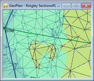

You can display the outlines of the underlying triangles that make up a TIN ground model.
TIN Triangles Displayed on the GeoPlan
Note:
You can only display the underlying triangles if the TIN ground levels are displayed as a theme.
Note:
You should only display TIN triangles when you need to use them. With triangles displayed the performance of the GeoPlan Window will be affected.
To display TIN triangles:
  1. display the ground model as a theme if it is not already displayed
  2. right click the GeoPlan Window and choose Properties from the context menu. This displays the GeoPlan Properties dialog. This dialog may already be open if you are setting the parameters to display the ground model as a theme at the same time
  3. switch to the General Page.
  4. check the Show Triangles in TIN Ground Models box to display the triangles
