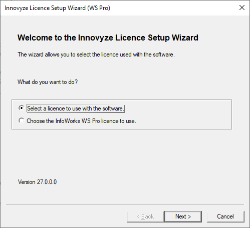

This wizard allows you to perform the following task for the Innovyze license:
- Select the license to use with the software
- Choose the InfoWorks WS Pro license to use
A subscription based Innovyze license is required to access Innovyze products. In order to use an Innovyze license, it is necessary to perform a simple configuration step on each client PC.
The License Key Setup program can be run from the Start menu.
When the program is started, the Welcome page is displayed:
The setup wizard option:
- Select a license to use with the software - Select the license to be used by the current user or all users on a client PC.
- Choose the InfoWorks WS Pro license to use - choose the license(s) used by the current user and therefore the options available to the user in those applications.
Click the Next button to display the next page of the wizard for the selected option.
