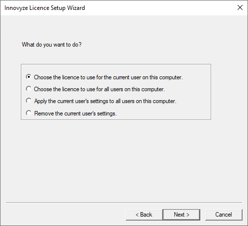

The Action Page of the License Wizard is used as part of the process of configuring the Innovyze license to be used by users on a client PC.
The options on the page are:
- Choose the license to use for the current user on this computer - Set license options for the current user only.
- Choose the license to use for all users on this computer - Set license options for all users.
- Apply the current user's settings to all users on this computer - Only enabled if there are stored settings for the current user. Requires administrative privileges.
- Remove the current user's settings - Only enabled if there are stored settings for the current user.
Current user settings will take precedence over settings for all users.
The Action Page is displayed when the Select a license to use with the software option is selected on the Welcome Page of the license setup wizard.
Setting the license for the current user / all users
To set the license to be used for the current user only, select the Choose the license to use for the current user on this computer option.
To set the license to be used for all users, select the Choose the license to use for all users on this computer option.
Click Next. The Settings Page will be displayed.
