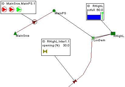

You can get visual feedback about some parameters on labels. If you select these parameters, a small graphic is displayed. The graphic is updated during replay of the simulation to give feedback on the state of the network object.
The parameters available are:
- Reservoir - Percentage Full - A graphic displays the state of the reservoir with an arrow to show if it is currently filling or emptying.
- Pumping Station - Pump State - An icon is displayed for each pump in the pumping station. Red means the pump is off, green means it is on.
- Valve - Opening - The valve
can be:
- Green - fully open
- Red - fully closed
- Grey - partially open
