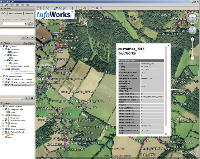

The left hand sidebar (Places pane) of the Google Earth main screen shows a list of all of the objects in the exported network. Folders can be expanded with the + signs to the left of their name. The check box is used to control the visibility of the objects in the folder (or the objects themselves when the folder is fully open). A dot means that some of the objects in a folder are visible; a tick is all of them, blank is none.
The objects which are initially shown on Google Earth are determined by what has been made visible in your GeoPlan window. Objects marked as invisible in the GeoPlan are present in the KML file, but are initially hidden from view. To show these, select the box by their name in the Places sidebar.
The Nodes are all clickable to reveal a balloon pop-up table of the node data. Each link has a smaller dot icon half way along: this can be clicked to bring similar information for a link.
If the network has some results then the results for the node or link will be displayed on the "balloon" table when their icon is clicked.
Customer points appear in Google Earth as a small rectangular icon about 20% of the area of a normal node icon. Customer points are in the same colour as specified in the GeoPlan.
