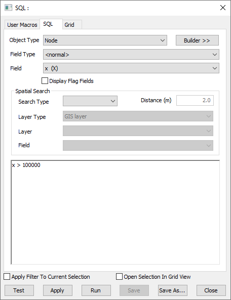

Example
x > 100000
selects all objects of the chosen object type (selected in the Object Type field of the SQL dialog) where the x coordinate is greater than 100000.
This basic selection example selects all node objects with x coordinate greater than 100000.
