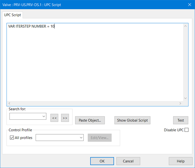

A variable can be added to the Valve UPC script, which can dampen this effect by reducing how frequently the valve updates its opening position.
In the UPC script of a valve, the following variable can be specified:
VAR ITERSTEP NUMBER = 10
This has two effects:
If ITERSTEP > 0, then the PRV prioritises flow balance over regulator balance.
If ITERSTEP = N, where N > 1, then the PRV will only change its setting every Nth iteration step.
For a chain of PRVs, you might increase this number with each PRV to reduce the interaction between them. This is best combined with the simulation option Enforce Valve/PST Regulation Tolerance.
