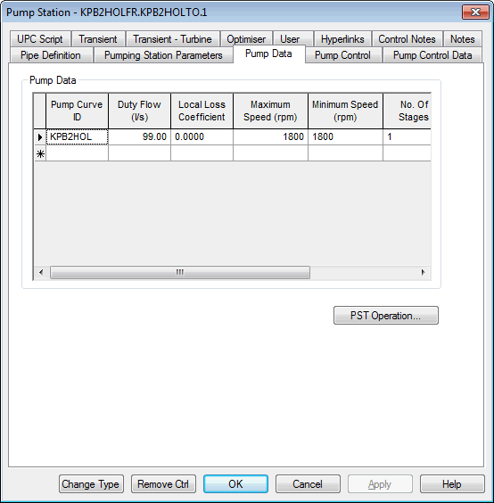

Allows you to view and edit all the pump curve specific data fields for this pumping station.
The data can only be viewed and edited on this page. For more information, see the Pumping Station Data Fields topic.
Pump curve information can be viewed and edited by right clicking the row of the pump to be viewed / edited and selecting pump curve from the context menu. For more information see the Pump Curve and Pump Curve Page topics.
Pumping Station Operation can be viewed via the Pump Data Page. For more information, see Pumping Station Operation dialog.
For more information on all link types, see Links. For more on this type of link, see About pumping station.
