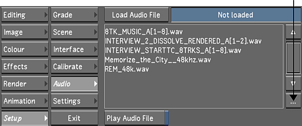

Click Setup in the Main menu, and then click Audio.
In the audio file list, click the Browse button.

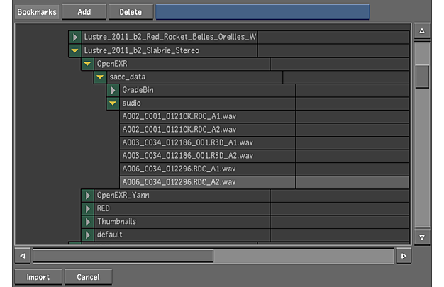

The Import file browser appears.
Navigate to the appropriate source folder and select one or more audio files (You can also use bookmarks to retain a list of folder locations). Traditional methods of multi-selecting (Shift-click, Ctrl-click) are enabled.
Click Import.
A copy of the audio file is imported into the Audio folder, and appears in the audio file list.
