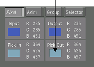

You can: To: Click Sample a single pixel in the image. You can drag through the image until you locate the pixel you want to sample, then click. Shift-drag Sample an average taken from a range of colours in the image. The sample appears in the Pixel Analyser.
Press / (forward slash).
The entire image is autograded according to the sample. The colours are rebalanced as shown on the Brightness Balance wheel.
