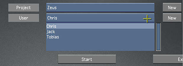

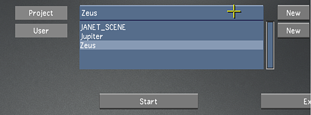

To load a project from the Lustre splash screen:
Select a project in the Project list.
Select a user in the User list.
Click Start.
