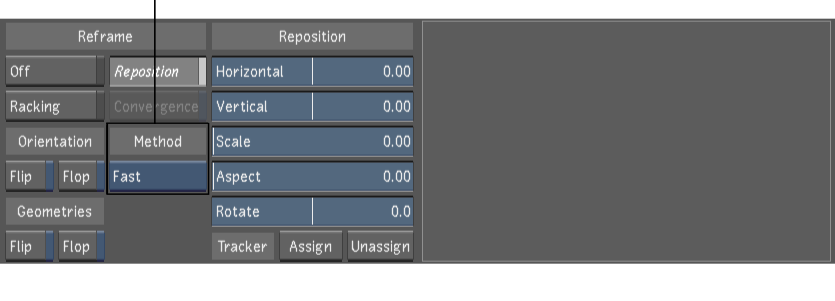

There are several options you can use to modify the way the repositioned images are rendered.
To set reposition rendering quality:
  1. Display the Reposition menu. See Accessing the Reposition Menu.
  2. From the Rendering Method box, select a rendering method.
    Enable:To:
    FastUse bilinear rendering. This gives fast display at a lower quality. Generally, you should work in Fast mode.
    QualityUse bicubic rendering. This gives higher quality but requires longer to display the frames. Use this option during MemCache rendering to show exactly how the image scaling will be performed in the final render.
    CustomUse the highest rendering quality. You should use this when performing the final render. This is the default method. It uses a Lanczos resize filter.
    Note:In Real-Time Deliverable mode, you can select additional custom filters. See Creating Real-Time Deliverables from the Timeline or Rendered Material.
